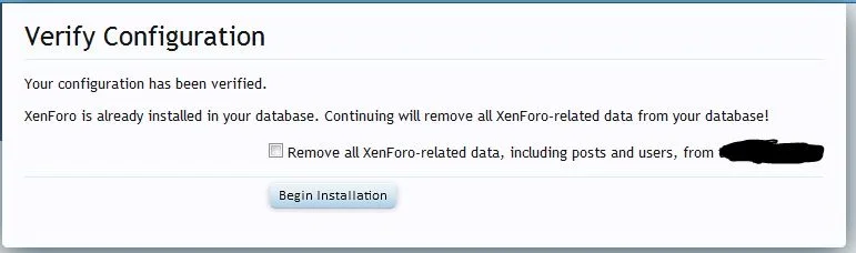

I am doing a test update and was suprised to get the following displayed
Have I done something wrong or is it normal for all existing posts to be wiped when updating?

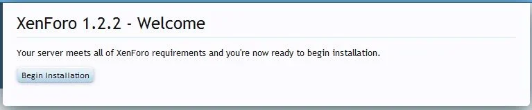

Going to /install/index.php?upgrade takes me to install/index.php?install/ and displays the following
After selecting begin installation I eventually get back to first screen shot in post #1.
