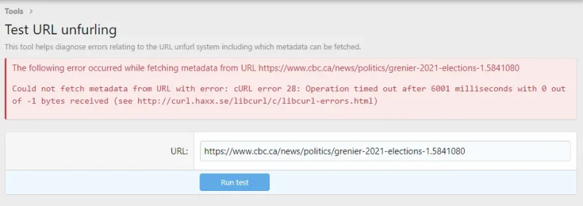

I run a predominantly Canadian board so we tend to post links to news stories on the CBC, Canada's government-owned national TV and Radio network, quite a bit. And they don't unfurl at all, not even to replace the URL with the headline as some sites do. Since I have not seen this with any other news sites, I assume it is something they are doing. It affects both mobile and desktop so I don't think it is related to their use of AMP on mobile. Does anyone have any thoughts on what is happening and if I can do anything about it? Or is this really on CBC's side and I just need to live with it. A story I posted on my site this morning is below.
It's an issue with that site - as you can see, it also didn't unfurl here.
You can use the tester in the ACP to check URLs.
