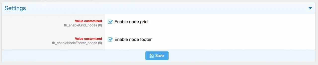

Jake B. Well-known member Aug 16, 2017 #1 Affected version 2.0.0 Style properties are showing "Value customized" if I've ever edited the value regardless if I've set it back to the default value, and I'm not seeing a way to actually revert it to the default to get rid of that

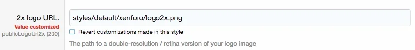

Chris D XenForo developer Staff member Aug 16, 2017 #2 You can't revert a value merely by setting it to the default (this is the same as XF1). The revert checkbox is underneath the modified property: Is there a particular property this is happening with?

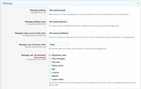

Jake B. Well-known member Aug 16, 2017 #3 Chris D said: You can't revert a value merely by setting it to the default (this is the same as XF1). The revert checkbox is underneath the modified property: View attachment 155904 Is there a particular property this is happening with? Click to expand... Yeah, the "revert" checkbox is what I was expecting to see but didn't so assumed there was something wrong It's a custom style property created in an add-on (though, just using the "Boolean" type so no custom templates) Able to replicate on some default style properties as well, for example: So I think the revert option is just missing on some types of style properties

Chris D XenForo developer Staff member Aug 16, 2017 #4 Yeah, seems to be type dependent. I can confirm this with the formSubmitSticky property. As a workaround for now, you can properly revert a property via Appearance > Styles > [...] menu > Customized components.
