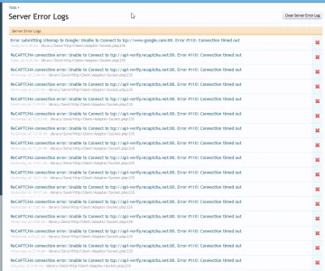

My forum is full of this error logs.
2017-05-15 11_05_43-Server Error Logs _ Admin CP - Olympus Gaming Network.webp
I haven't checked the admincp for over 1 month so I cant really say when it started happening.
Any idea what is causing it?
It's a communication error between your server and the outside world; specifically Google (for sitemap pings) and ReCAPTCHA.

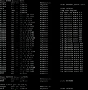

As you can see in the attachment the policy for the output is to accept it. So I dont think the problem here is the iptables configuration.

It may not be that exactly, but the issue is effectively happening outside of XenForo's involvement. All we're doing is performing a HTTP request and that is failing. That failure exists between your server and the URL being requested so there is most certainly something blocking it somewhere.
Absolutely, there's not really anything to configure here. It should be a fairly simple HTTP request and there shouldn't be many reasons that should fail.
