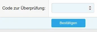

Using <input type="number"> renders spin buttons which are kinda pointless for 2FA codes. :)
