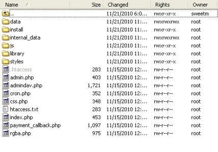

TNCclubman
ive chmodded those folders as well 777. ive attached winscp (which I downloaded and used that to upload the files again, still says forbidden)
Blandt
Most likely your domain is pointing to the wrong folder :)
go back to cpanel and verify that your domain root folder is actually what you think it is :)
