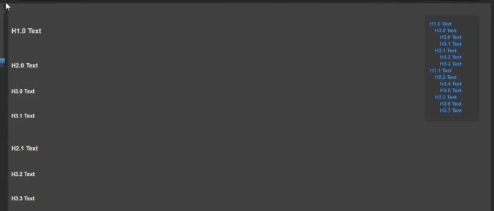

Brilliant, that's just what I was looking for. It provides an array with various sub-parts of the full HTTP address including one called 'requestURI' that I could use to resolve my TOC links.
So I already have a fully functioning TOC, I just need to implement the look ahead parsing and make the whole thing pretty.
After implementing the message parsing to build the TOC I can put the TOC where ever in the post, all that from BB formatter without too many ugly hacks.

As explained above I got the core feature wrapped up. I've also dealt with CSS styling and got something like that:
Now I'm trying to tackle wysiwyg. I've implemented a wysiwyg class which outputs HTML headers too and that works nice when first editing your post. However going through an edit cycle my HTML headers are converted the BB codes like:
