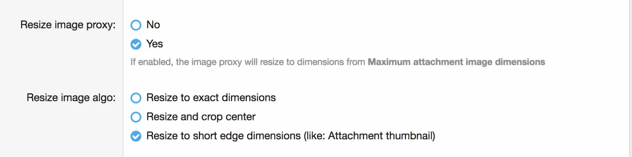

This is the feature I really need before buying it.Hi @truonglv, does this addon resize the cached proxy images to predefined maximum physical dimensions (pixels), or to ones set in the ACP -> Options -> Attachments: Maximum Attachment Image Dimensions?

- Added new feature to resize image proxy to another dimensions
