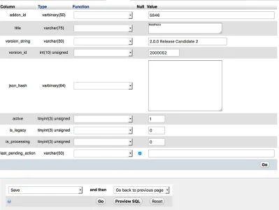

Well that's a very odd value in the add-on table, though it does seem to imply to me that an upgrade is actually pending. If you go to the upgrader, does it indicate this?

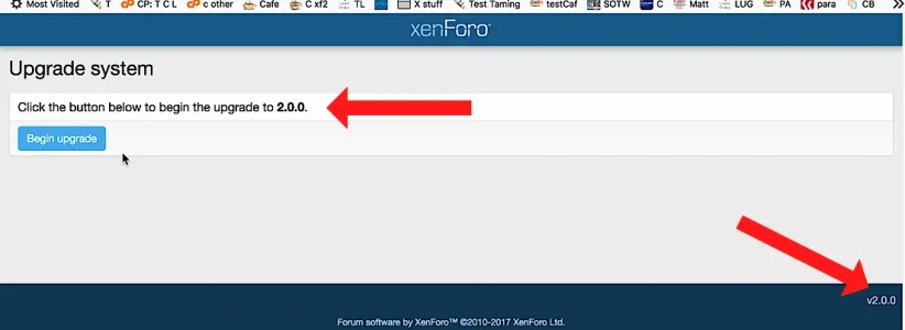

Well that does mean you have a pending upgrade, though the only way this would magically appear would likely be if the DB somehow got rolled back. But you would need to complete the upgrade process then.
That is not possible (as there are no daily backups on that server that I can use to restore) so the only would be for me to have manually downloaded and restored via bigdump, and that didn't happen.
However the good news is I did the upgrade from 2.0.0 to 2.0.0 and all is fine again.
