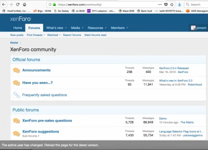

Cannot reproduce The active user has changed error
It generally indicates you’re logged in or out on one tab and then either logged in as a different user or logged out or in on another.
If you can provide context as to what you were doing it will help, otherwise it’s likely just doing what it was designed to do.
I only had one tab of xenforo.com open at that time and so I wasn't logged in/out.
I wasn't doing anything really on the forum

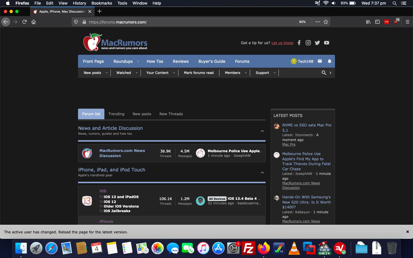

I have a member on Firefox reporting the same issue. The bug report is closed as "cannot reproduce" but it is still an issue for some people.
The fact that it's not everyone who uses Firefox makes me think maybe an extension is messing with the Javascript. Do you guys have a list of extensions installed? Maybe we can find a common denominator.
We hadn't had any reports about this for a fairly long time so I was beginning to think it was something that Mozilla had fixed in a recent update.
If you can confirm the specific Firefox versions involved, that will help us confirm if it's still an active issue.
