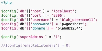

I ran into an issue when using the guide by Brogan to create a separate test site. Normally it works, but this one threw an error I have not seen before:
Parse error: syntax error, unexpected 'db' (T_STRING) in /home/xxxxx/public_html/url.com/oman1/library/config.php on line 6
I followed each step - copied and imported the database, copied the files over.
Can you suggest what I might have done wrong this time?
The format of the password line is as follows:
$config['db']['password'] = 'PasswordGoesHere';
That is line 6, and it is just the password placed where the old one used to be. Did I miss something in that line?

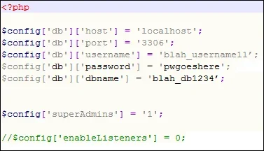

The error could be before that line or there could actually be an invisible character that got inserted by your editor (I've seen that happen once). What's the whole thing (with sensitive bits replaced)?
<?php
$config['db']['host'] = 'localhost';
$config['db']['port'] = '3306';
$config['db']['username'] = 'blah_username11’;
$config['db']['password'] = 'pwgoeshere';
$config['db']['dbname'] = 'blah_db1234’;
$config['superAdmins'] = '1';
//$config['enableListeners'] = 0;
That's a "smart quote" at the end of the line.
It's on the DB name line as well.
Ah okay that explains it.
