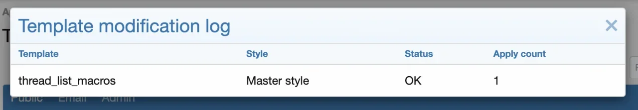

Not seeing an issue with that exact TM here so we might need more details including information about the errors it is throwing.
If you can provide a screenshot of the TM log too that may give details of what/why it isn't applying:
I've added that template modification 3 times locally. The only difference I did was add a [1] (2 or 3) to the beginning of the replace to make it clear it was being applied multiple times. All 3 cases applied simultaneously without issue.
