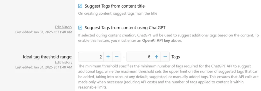

Can this turn off WikiTags yet? I'd prefer to use OpenAI tagging only as most the content on my general forum doesn't operate under topics found in Wiki, for the most part.
I can appreciate that AV forums does (to possibly pull a specific camera model Wiki, for example), but I'd just like to use OpenAI suggested tags and that's it.
Wikipedia is used to find more information for a tag. ChatGPT adds tags based on the thread title and first post content.
They are two different functions.

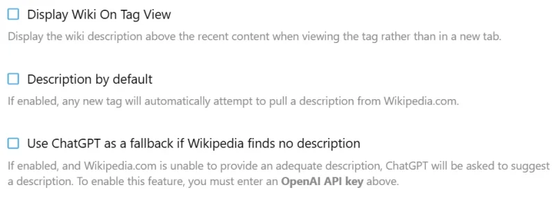

I could never get it to work without WikiTags (i.e., a tag displaying a Wiki if there was one).
I just want tags auto-created by ChatGPT.
Notice "Use ChatGPT as a fallback."... This means that Wiki is used first, and if no tag, falls back to Wiki. I want it to always query ChatGPT for "Give me 5 forum tags for this text: " (or something to that extent; it will always give you good tags if queried right) and only use those.
No Wiki fallback.
But is it going to use Wiki regardless? This seems to suggest it will only use ChatGPT if no Wiki is available at the same time to suggest tags using ChatGPT. Kind of confusing, to say the least.
And, is there an option to batch auto-tag older content? (Will be expensive, I know)
i believe thats the "description by default" option from my first shot....the wiki is for "description"...different from tag suggestion.
yes, but it can be good to do in bits and monitor because its adding new tags then once they are in the system they will more likely suggest again...so you want to block/merge tags as you go if you get me, maybe even run it a second time even, but you can start to get a solid tag list...the tools are there

Let me see how the updated one runs.
I disabled it because it didn't ChatGPT tag (only Wiki tag) and it was uninstallable (Tag Essentials 2.6.2). Hopefully, after upgrade, it can be uninstalled. But, that wasn't my concern with it as I wanted auto-suggested ChatGPT tags and batch-update tags using GPT only.
I think @frm means that he wants to turn off Wikipedia article display on Tags pages. Hence Wiki-tags.
I’m investigating having a single admin option to enable/disable the use of Wikipedia for tag information.
No Wiki fallback.
I’m not sure whether the ChatGPT fallback has ever worked. I’ll investigate.
This is something that I want to do.
There are two issues. The first is cost. It might be possible to burn through your OpenAI credit quickly.
The second is the time it takes to run a ChatGPT query. It’s so long that a batch update of threads is going to have to be a batch process much like the ones we run in the Rebuild caches section.
