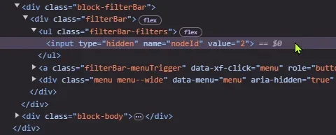

I was finally able to track down an issue where the "Clear All" filter button added by AddonsLab's filter add-ons was always displayed on the filter bar, regardless of whether there was actually an active filter, as well as some odd behavior with other add-ons which touch the filter bar.
I tracked it down to the avForumsTagEss_forum_view template modification which adds <input type="hidden" name="nodeId" value=""> to the filterBar-filters list, even when there are no active filters.
Modifying <xf:if is="$xf.options.enableTagging"> in the template modification to <xf:if is="$xf.options.enableTagging && $filters is not empty"> seems to have resolved the issue, but I have no idea if this is an adequate solution. If so, it'd be nice to have this simple fix incorporated :)

I appreciate the update. unfortunately this is still occurring.
I believe there was a misunderstanding, as we actually do have content tagging enabled. The issue is that this hidden input element is added even when there are no active filters, making other addons behave as if there are active filters (they're checking to see whether the <ul class="filterBar-filters"> list is populated).

The last update wasn't in reference to your issue. Your issue is caused by a different addon though it looks like the TagEss code needs tweaking. I have asked the coder to have a look.

The coder has had a look. The fix is not trivial so it’s been scheduled in and will take a while to get to.

Ah, thanks for the update. Is there something wrong with this simple fix? Seems to be working fine (but I'm not a dev). I'd hate to have the dev rewrite a bunch of code when a simple template modification update would do.
