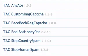

Can you also update FBHP and CIC (since these don't look like the latest versions, and I don't want to spend time trying to work out why a not up to date version isn't working)

I've tested this add-on locally on its own and in conjunction with CustomImgCaptach, I didn't get this warning
There are many reasons why the core might detect you as being "spam like", can you check your core logs and it might give you a clue
THESE ARE CORE LOGS (please let me know what it says):
https://8th.us/admin.php?logs/spam-trigger

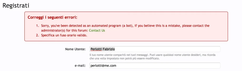

I've some trouble with this last version... all user rejected with a strange request on time zone setting...
Disabled for now
Disabled for now
@giorgino
I need more info than that. What is the message?
Do you use an add-on or other that manipulates the timezone, or do you modify the registration form template.

The message was something like "please insert password" and "please set the correct time zone".
The only template modification I use, is a customization of date of birth (in italian format DD-MM-YYY). No other mods in registration form.
You can take a look at www.immobilio.it
Is that an Add-on you have used, OR have you manually edited the registration_form template? (It's a bit unclear from what you said)
