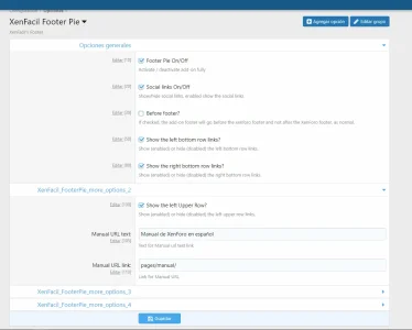

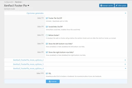

If you want have full-width separators collapsibles, you can use:

Ifr you want that all full-width separators shown as collapsed, remove both " is-active". If you want that only show opened the first full-width separator, remove only the second " is-active".
Change the bolded Your_Namespace into phrases by your namespace and change the bolder your_namespace_addon by your option group id.
If you define only to 499, only shown the general options tab and four more.If you define to 2000, shown all the 14 tabs with all the options configured, those greater than 1100 in the last tab.
Work fine for me.
Salud2
