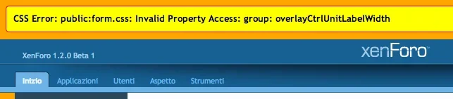

So, after upgrade procedure the site is unreachable (error 500) and many add ons are impossible to deactivate.
And in adminCP I have this alert:
So I entered in phpMyAdmin and disabled all addons setting the active field to 0, but no still no luck.
So I've done this:
but still no luck...
Disabling listener the site is on line...
$config['enableListeners'] = false;
What can I do?
That means your style is using an old style property. You need to update your style for 1.2. That means reverting any outdated templates thereby removing any references to old style properties. Or contact the style author to obtain an updated version of your style.
