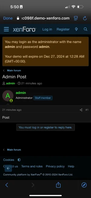

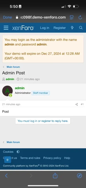

So, here's a good example:
The very first view of this will be blue (default XF color), but the second view will be a green, depending on system preferences a dark or light green. I think it's only occurring on the 1st full render...
The first view is green, as intended. It will never be blue with the rules you've applied. That's true whether using the system variation or an explicit choice.

Ah, a critical issue I left out.
It was on iPhone/Apple devices. I could always see it on my end.
I can't reproduce that and there's no reason that would happen barring a Safari/iOS bug. The device decides whether to apply the light or dark rules. In any case we're fairly confident there aren't any bugs with the way we handle this.
