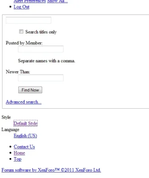

Thanks Mike for ur reply.. Here's what i did.. i tried to log in from a different browser (FF) as administrator.. it was hanging for more than 2 mins and then this happened
The page was loaded but all layout was broken... fortunately i could choose the child style again.. and it got resolved.. However, i still have a doubt as to why am i not able to work on the default style..I am running version 1.01.. Should an update to 1.02 fix this? BTW i have been using a child style before i started using version 1.01.

That shows the CSS failing to load, which generally shouldn't happen. I'd really have to see the output and do more debugging.
I would probably say try 1.0.2 - if worst comes to worst, you can always change your style in the admin CP. If you still have the issue, then I can dive into it further.
