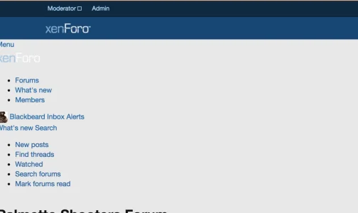

the header of one of my local installs did not perform great. The content is there, but the style is obviously messed up. This is the header I see
It doesn't go away if I rebuild everything. I'm not sure how I could fix that. No custom styling etc.
Would it be possible to provide the URL to this? Are you using CloudFlare? If so, do you have auto-minify enabled?
You hit the nail on the head. I did have the minify option enabled. Didn't realize that would have an affect. Disabled and the test site is now working.
