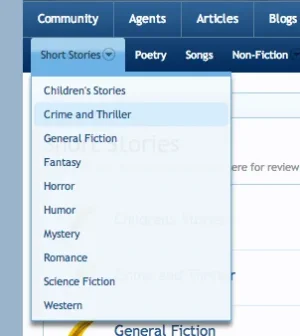

How can I add a drop-down menu to the secondary navigation tab (displayed when a parent tab is selected)?
I've tried and searched, but haven't had any luck. Trying to mimic what I get automatically when using the nodes as tabs plugin (see attachment). I'm trying to do the same but with custom links.
I suspect I'm using the incorrect classes. (Popup PopupControl PopupContainerControl PopupOpen for the li class as the main secondary menu link and "secondaryContent blockLinksList" for the lower ul class. No luck. I'm not sure how I can find the right classes - already tried finding it by using "Inspect Element" in Chrome. Can anyone shed light on this?

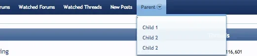

I've more or less got it - I'm making progress anyway. I still need to edit the CSS, but using this code in the navigation template I've managed to add a secondary-drop down.
Here's the relevant part of the navigation template (for others trying to do this as well, and hopefully to help with the problem below):

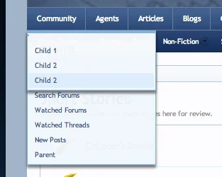

My problem is this: I'm now seeing two drop-down menus from the same parent (Community) navtab. See the attachment.
I suspect this has to do with a particular class, or I need to restructure the surrounding divs. Any tips?

I suspect it has to do with this div or classes within it:
                <div class="{xen:if {$tabs.forums.selected}, 'tabLinks', 'Menu JsOnly tabMenu'} forumsTabLinks">

I did manage to get the effect I'm looking for (right before you posted, didn't get a chance to look at that code). Drop-down secondary menus without a duplicate drop-down menu from the parent tab. I'm not so sure it's the most efficient way to do this, but it seems to work.
I had to duplicate a large part of the menu so there's a separate list for those acting as a drop-down from the main tab and those acting as the secondary link when the tab is selected. In the duplicated portion I removed the Popup and PopupControl classes, which enables it to act as a secondary menu list when the tab is selected but doesn't Popup the drop-down menu from the parent tab. Color-coded below.
Edit: looks like removing the popup and popupcontrol classes had nothing to do with it, rather it's just the duplication of the list so one acts as the submenu list and one acts as the drop-down for the primary forum tab.

                <div class="{xen:if {$tabs.forums.selected}, 'tabLinks','Menu JsOnly tabMenu' } forumsTabLinks">
                    <ul class="secondaryContent blockLinksList">
                    <xen:hook name="navigation_tabs_forums">
                        <xen:if is="{$visitor.user_id}"><li><a href="{xen:link 'forums/-/mark-read', $forum, 'date={$serverTime}'}" class="OverlayTrigger">{xen:phrase mark_forums_read}</a></li></xen:if>
                        <xen:if is="{$canSearch}"><li><a href="{xen:link search, '', 'type=post'}">{xen:phrase search_forums}</a></li></xen:if>
                            <li><a href="{xen:link 'watched/forums'}">{xen:phrase watched_forums}</a></li>
                            <li><a href="{xen:link 'watched/threads'}">{xen:phrase watched_threads}</a></li>
                        </xen:if>
                               <li><a href="{xen:link 'find-new/posts'}" rel="nofollow">{xen:if $visitor.user_id, {xen:phrase new_posts}, {xen:phrase recent_posts}}</a></li>
                                        </xen:hook>
                        <li class="Popup PopupControl PopupContainerControl"><a href="#" rel="Menu">Parent</a>
                        <div class="Menu JsOnly tabMenu">'
                                  <li><a href="#" class="natMenuLevel0">Child 1</a></li>
                                          <li><a href="#" class="natMenuLevel0">Child 2</a></li>
                               </ul>
                               </div>
                               </li>
                    </ul>
                </div>
            </li>
        </xen:if>
Any glaring conflict with doing it this way? Seems to work perfectly.
