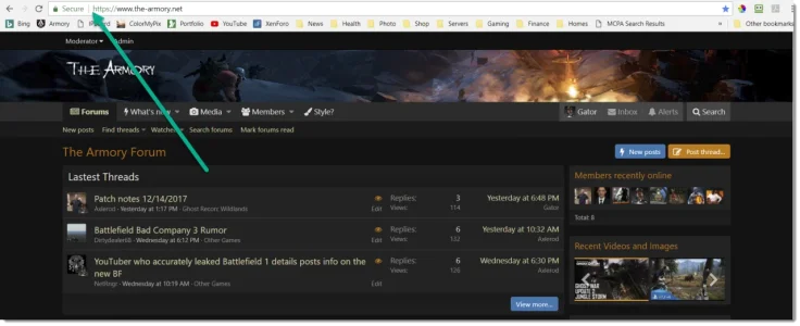

I have an SSL running on my site as seen here:

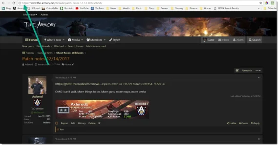

But when I select a thread, I lose the Secure lock:
If you check the browser console (usually F12) then it will likely list the issue in there. It will probably be an image that's being served over http rather than https - it would cause a mixed security warning.
The solution would be to enable the image proxy.
