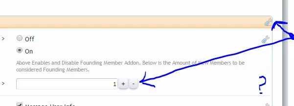

Does anybody know how to get the "reset" button working with spinbox through admin template?
I can get it working with this:
<input type="hidden" name="checkboxes[]" value="{$property.property_definition_id}" />
<xen:spinboxunit name="properties[{$property.property_definition_id}]" value="{$property.propertyValueScalar}" label="{$property.title}" min="1" max="1000" step="1" />
<xen:include template="style_property_unit_extra" />
But that isn't right as you can see here:
If I try and save it with this:
<xen:html><xen:include template="style_property_unit_extra"><xen:set var="$reset">{xen:phrase reset}</xen:set></xen:include></xen:html>
It Errors and doesn't save.
Any Help is much Appreciated!

Your right! But as you can see in the image above,the edit icon doesnt line up right. That code was taken from a admin template that had radio buttons. I am needing a spinbox and Without the below code, I do not get the edit icon in adminpc which I am trying to achieve. Any Ideas?
