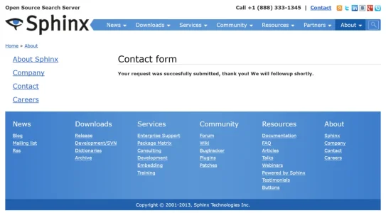

I have contacted Sphinx Search directly as a general inquire in regards to their Sponsored and Custom development.
Hopefully the reply will be favorable. And we can involve Sphinx Search in developing an add-on for XenForo.

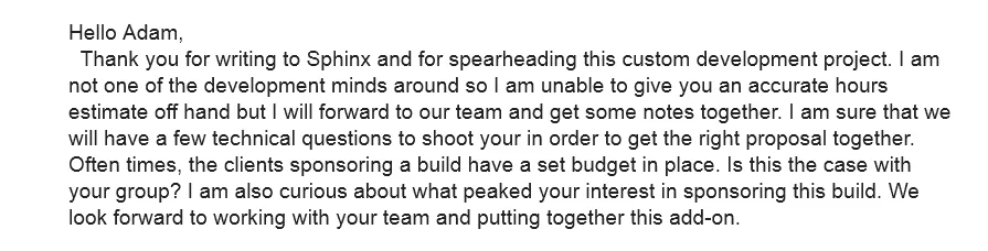

I got a reply....
Seems as though they maybe interested in the idea :)
Adam would be you kindly to paste the text here, I think some users use a translator to read xenforo.com and at this moment the translator still does not read the images.
Thanks, Luis.
QUOTE:
Hello Adam, Thank you for writing to Sphinx and for spearheading this custom development project. I am not one of the development minds around so I am unable to give you an accurate hours estimate off hand but I will forward to our team and get some notes together. I am sure that we will have a few technical questions to shoot your in order to get the right proposal together. Often times, the clients sponsoring a build have a set budget in place. Is this the case with your group? I am also curious about what peaked your interest in sponsoring this build. We look forward to working with your team and putting together this add-on.
