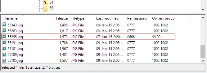

This time I made a backup for the whole user account which includes database and all folders and files of the root directory and restored it to the new server here is one of the broken avatars:
Not Found
The requested URL /community/data/avatars/s/55/55255.jpg was not found on this server.
when I searched for that avatars 55255.jpg in FTP I foundout it exist but have permission of 666 !
I tried to change the permission to 777 but it says
Response: 550 Could not change perms on 55255.jpg: Operation not permitted !
How to fix this?
I am having now a broken thumnails attachments (but the full image attachments is ok) and I have to chown to fix the broken thumnails attachments that are already posted but the problem keep happening again and again with every new thumnails attachments when posted and I have to chown again and again to fix the problem!!

And what user/group is 99? It looks like nobody:nobody on my CentOS box.
If you look at your image, that file you highlighted was changed to nobody:nobody as the owner. Either you have script (cron) running that does that or your PHP processor changes it (and if it keeps redoing the same ones, it's a server issue).
if nothing else, you can set up a script to run in a cron to reset the ownership every few hours - but that's only a band-aid solution. You need to find out what on y our server is changing the ownership.
