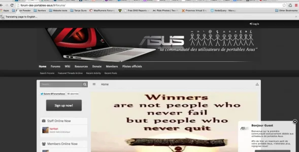

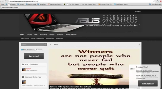

Probably due to the fact that you have it available with both the WWW and non WWW site. You need to decide on one or the other and then redirect to that one. You also need to make sure that your URL's in the ACP correspond to whichever one you decide on.... that is, if it's your Asus forum you are asking about. If it's another then you a link would help.
Screen Shot 2015-02-17 at 5.54.28 PM.webp Screen Shot 2015-02-17 at 5.54.42 PM.webp

Depending on your HTTP server, it's controlled via htaccess or the vhost definition.
What I mean is I can reach your site at
http://www.forum-des-portables-asus.fr/forums/
or
http://forum-des-portables-asus.fr/forums/
You need to decide if you want the WWW shown or not, and then use the redirect via the htaccess method or if using nginx in the vhost to direct all connections from www to the non-www or vice versa.
