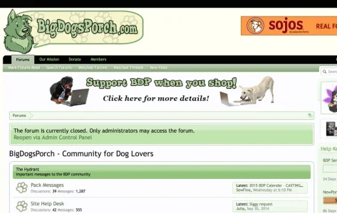

I edited the cron jobs so that the files backup is 2 minutes after the database backup which is set at 3.00AM.
I select the Put Forum in Maintenance mode for both database/code.
What I found is that after they both run, the board is still closed for guest.
That's because of the first problem. The process replaces that message with "hang on tight" while the backups are running, then it is supposed to put the original message back when the backup is done, but obviously, it doesn't look like one of the backups finished.And also that the previous Board Active message replaced by "Currently running backups, hang on tight."
Thanks - my issue with the message was user error LOLThat screenshot you see is what admins see, that message doesn't get changed during the backup. Non-admins should see the message that you've set in the options. To test that, open an Incognito Window (in Chrome), and browse your forum while the backup is running, and you should see the appropriate message.
