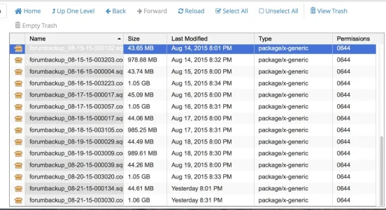

Just curious.. I thought if I wanted 1 backup of each (sql & code) that each time it backed up, it'd delete the old backups that were made so there's only 1 of each.
Mine just build up like so..
You and @Rambro might be having the same issue, maybe permission related. Does this problem only happen with the code backups, or both the database and code backups? Just curious, as your image shows 1 database backup.
If you have the debug option turned on inside the "Miscellaneous Options" tab of the addon, can you send me the last 200 lines of the debug log in your backup directory in a personal conversation? There might be an error in there indicating why older backups aren't being deleted.
Sorry I forgot to get back to you on this Dave. I just turned on the debug option and will get you that code. I get backups of both the database and code:

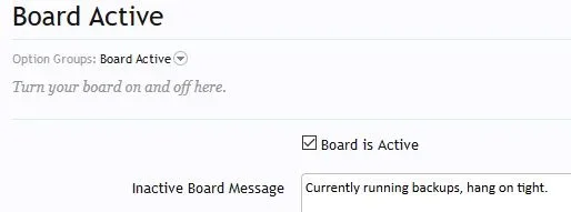

Hi This is a great add on to have.
After auto running the backup with the "Put Forum in Maintenance Mode" selected
my forum displays the below message and does not come out of maintenance mode.
the next morning when I wake up I needed to go into admin to make the forum active manually.
How can this be prevented so the forum does not stay in maintenance mode all night?
the check box gets unchecked when backup is activated
and the check box does not get checked when it is done?
until I go into admin and check it.
I run into this on a shared server. I have my cron jobs 30 minutes apart and what happens is that one times out and throws a server error, but you don't see that when it runs on a cron. For me, it's the Code cron that does it because that is larger and I think the zip process takes up too much resources and the host kicks it out. You can see if this is the problem by manually running the Code cron a few times and see if you get an error screen at some point. What happens in this case is that the job does not complete, and you don't get an email alert either saying it did complete, because the process got kicked out by the host. Sometimes you will have a .zip file generated and other times not, for me it usually is which is odd. But the bottom line is it is usually host related and resource related.
My solution to this was to recommend breaking up the cron by excluding a directory, which is why that is now an option. I exclude images which is the biggest one. That seems to help but not completely, I think the resources taken up are stil too much for some reason. But I haven't dove into it again lately. I just uncheck the "close board" option so that it doesn't shut the board off.
also make sure your crons are spaced apart. If they run at 4am or something, someone has to ping the site to trigger the cron and if no one visits until both are due one can run right after the other and sometimes that doesn't play well.
I also run this on a VPS and it never errors out and I always get both backups with no problem, and the board is set to shut down during each cron. So my conclusion is that it is host related.
If you're forum is staying in maintenance mode for long periods of time, then your backup probably isn't working correctly.
Floyd is correct. I've noticed some shared hosts throttle or kill longer running processes, or ones that use 'tar' and/or 'gzip' that can use a lot of CPU. This seems to happen more on the code backups than the database backups due to the size of the file.
You can follow these steps to try to identify the problem, or send me a conversation, and we can discuss.
1) Go to your "Code Options" of the addon, and uncheck "Put Forum in Maintenance Mode?"
2) Go to the "Miscellaneous Options" and turn check the "Debug Mode?" box.
3) In the XenForo admin, go to the Tools -> CronEntries page, and find the "ForumBackup / Code" entry.
4) Hover over the "Controls" menu for that cron entry, and click the "run" option. This will manually run the backup task.
5) Find a debug/log file named [yourbackupfilename].log in your backup directory, either via FTP, SSH.
6) Look at that log file, scroll to the bottom of it, it will have the details of the backup process in it. Each backup task should have a "START" and "END", with a step by step of what's going on in between those lines. If you don't see an END steps for a backup task, then the script is getting killed, and not finishing.
Send me a PC with the most recent details from your debug log if you have any questions, or want me to look at it.
