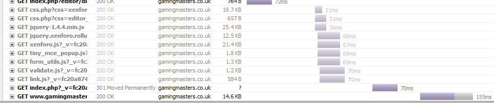

It's a lot faster on my own site where the Javascript files are cached with Expires headers and no 304 request/response is necessary. However there is still an odd request for index.php, after the Javascript is loaded - the same thing occurs on XF.com.
The iframe does not load until the index.php request completes.
Yea same here I see close to no-delay where the JS are cached with Expires headers
