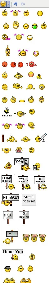

I have about 90 animated smilies (*.gif). How can I
1) convert them into sprite?
2) get smilie block like table with normal height. Now it is too long: manysmiles.webp
You can't use sprites for animated images.
You can increase the width by adding this to EXTRA.css:

Thank you very much, Brogan! I failed passing the quest "Improve editor without manual". I hope new forum release will bring us more transparent and admin-frienly way to set it up. For example, another problem is to add new BB-code buttons.
