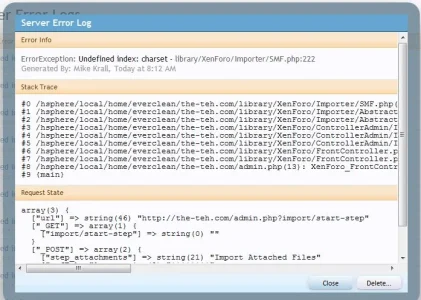

The other is I have 4 pages of these errors, not sure if it's nothing or something:
Can some please offer some advice?

That error is a little strange, but it's from during the import and if everything worked, it can be ignored.
