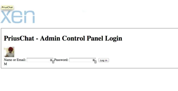

Also, I can't log in to my admin. Instead of the styled version of the admin, I'm getting a white screen with 2 boxes for login, but after I enter my credentials, I just get a refreshed page and a "M" on the screen in place of an error. Nothing being filled in the error log, either.

If I remember correctly, the ACP issue is related to incorrect db config for the ip changes.
Really what you need to do is run a schema compare between your existing database and a clean db of the same version.
That will then indicate where the issues are and what needs correcting.

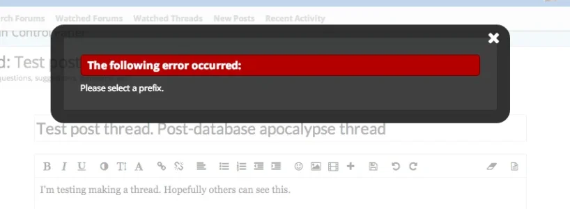

I've had the database reimported and things seem to be much better, but there are two things that stand out:
  1. My forums show the threads in Ascending order (oldest first) instead of Descending (newest threads first).
  2. I'm getting an error when trying to create a thread. "Please select a Prefix". On forums where I do actually have thread prefixes, I can post threads. On forums where I don't have thread prefixes, I get this error:
I am going to be doing an update to 1.4.x soon anyway, so is there a chance these issues will rectify themselves while going through the upgrade process? Do the upgrade scripts check the validity of tables or anything like that?
