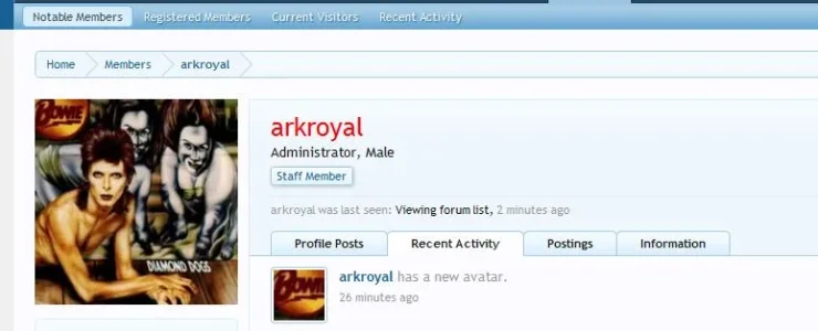

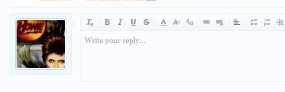

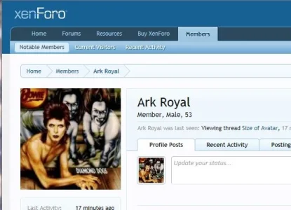

Possibly since upgrading to 1.2.3 I have noticed that my Avatar looks different depending where I look at it, see below.
Previously it was always the same image, rather than a zoomed version. Is it possible I have changed a setting somwehere? If so how do I change it back?
Many Thanks
AR

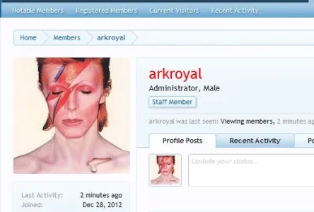

@Mike it appears to be inconsistent behaviour depending on the image being used for the avatar.
The 'Aladin Zane' image behaves as I expect but the 'Diamond Dogs' image does not.

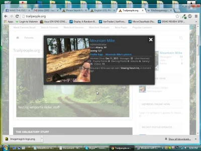

Can anyone tell me if theres a setting somewhere or a file edit that would fix the avatar in the member card from cropping incorrectly? I made some changes the other day to change the L avatars from 192px to 222px and everything looks good except the member card.
heres what the L avatar looks like in the member profile...
