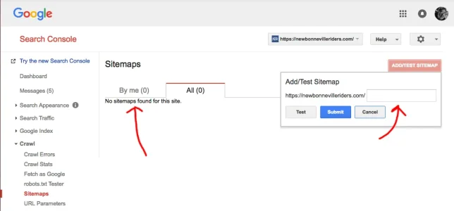

I don't understand how the XF 2 sitemap feature works. I see it there in my Admin console and it looks like it is turned on and supposed to be working. However, my Google Search Console does not seem to see the sitemap. There does not seem to be a way to even direct Google to see it. Any ideas or suggestions here?
Sorry, but that doesn't help much. If that is required, why or where is that information communicated to a new XF 2 user/owner? In other words, type "sitemap.php" where?
Well, under "Add/Test Sitemap" there's a text field. Add "sitemap.php" there to submit your sitemap to Google.

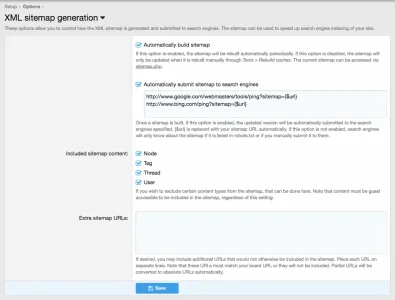

This page:
...tells you what your sitemap URL is.
"The current sitemap can be accessed via sitemap.php"

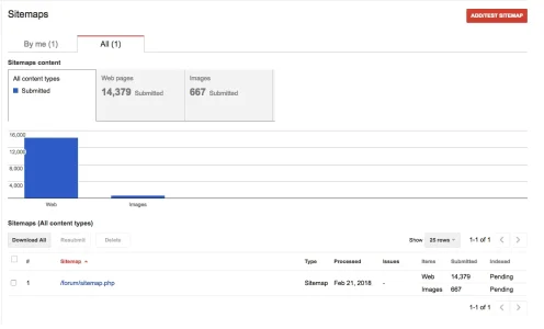

Wow... that is just really not very clear. Thanks for the tips and help - much appreciated. Looks like it worked!

Hi @Chris D , I have a 5,000 thread site that is generating an enormous sitemap.xml file - doesn't seem to want to index it like yours. Am I missing a config setting or something else? Right now I can only set it to show nodes
If only nodes are showing in the sitemap then you likely need to go to Admin CP > Setup > Options > XML sitemap generation and make sure that you have "Thread" checked under "Include sitemap content"
If that is already checked, go to Admin CP > Tools > Rebuild caches > and run the "Rebuild sitemap" job to see if anything changes.
