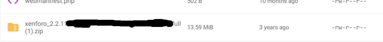

Also, I still have this zip file in Public_html at the bottom of the list - when I first started the site I hadn't a clue how to upload it to the server, so the server did it for me or walked me through it - can't remember. And I think it involved unzipping the file within public_html. I assume that shouldn't still be there! Is it ok just to delete it?
Yes, it is safe to delete this file.
It didn't like that at all! When I went to delete it - big red warning and said you don't have permission to access this and everything disappeared. Reloaded file manager and it all seemed normal but the zip file still in there. I think I'll just leave it there if it's not a security risk!
It's just a permission issue. The file is safe to delete.
The file is currently residing in public_html so there is a risk of someone accessing and running that file - you really should get it deleted when you can.
Thank you for the tip about permissions. Done.
