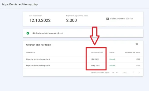

xenforo allows a maximum of 50,000 urls in the sitemap file, then splits the sitemap file, this is fine for a new forum site for google, but for a forum site restored from backup, google does not read this sitemap file.
in later xenforo versions the sitemap file is less than 50,000 or max. Is it possible to have 25,000 urls?

Googlebot should read my sitemap file every day, but the last one read it 14 days ago, but also didn't read it, which is because the url is too much.

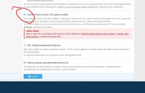

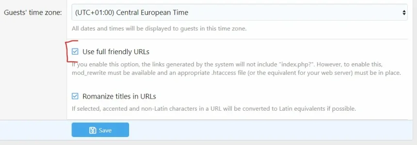

The XF Sitemap doens't work properly. Last time I asked about this, I was told I neeed friendly URLs on for it to work.
I cant read Turkish but you have an error message, read it and do what is necessary accordingly to it.
Maybe your .htaccess file is not well configured for friendly URLs
.htaccess How should the file be? can you write it here for example like this for me

We've got the same so check if the mod_rewrite is activated in server side (Apache info or nginx, etc...)

I can access mine but Google responds with saying it'd not fetchable. Sitemap.php works well though. Google can't fetch the sub sitemaps listed in sitemap.php though.
