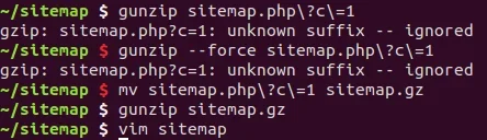

I had to rename the file and add the .gz extension before unzipping.
Screenshot from 2014-08-09 21:15:26.webp
Works perfectly.
