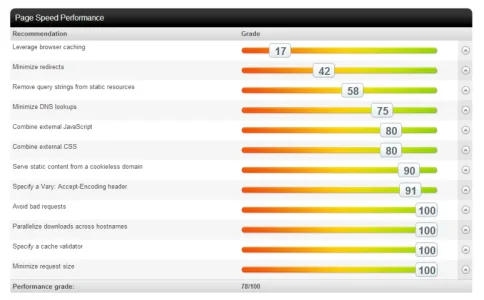

So the site has been abnormally slow lately. I did a site speed test and this is what I got. Is this my server or something within the software that I can adjust? Any help would be much appreciated!

Are you on shared hosting or a VPS/Dedicated server. If VPS/Dedicated you need to set expires in the headers for your images, css, etc. That will help the first one (but if you do adsense and some other sites like that it wills till show lower than 100%).

They should already be caching your images, etc. Expand the arrow and see what is not being cached. Sounds like they are poorly configured. They could also be oversold on the node you are on. Is this one of those "economy" shared hosting plans?

What arrow? Lol. Not sure what that means.
If you look to the right of the bar that says 17 you will see a little arrow in a circle... that arrow. :)

I also have some redirects that it says is slowing it down. I don't have a site homepage so when you go to mysite.com it redirects to community.mysite.com and then to communit.mysite.com/index.php Does it need to end at index.php and if so I guess I can change the middle redirect eliminating one of them...
