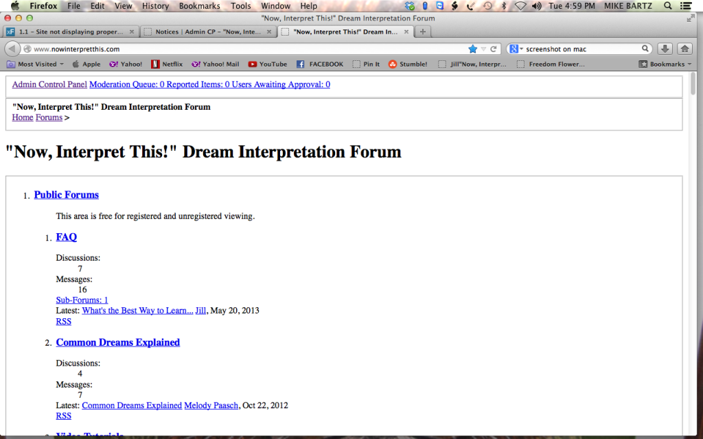

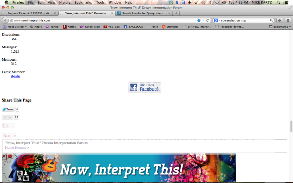

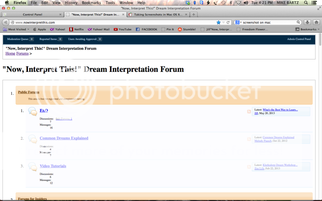

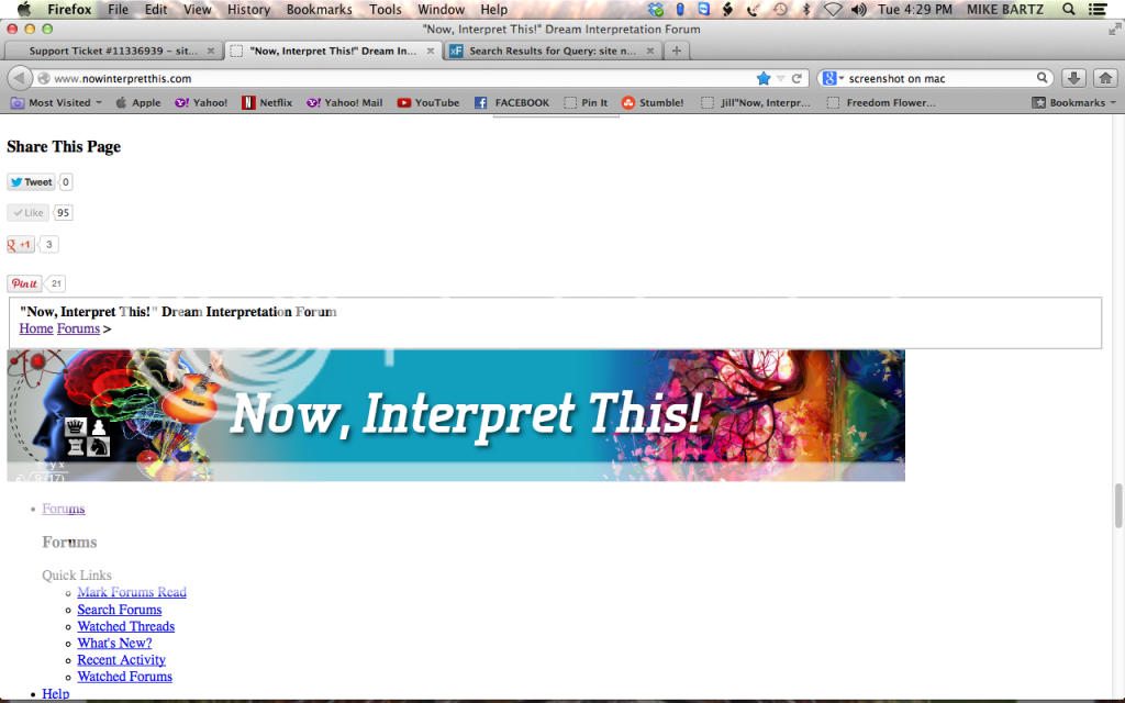

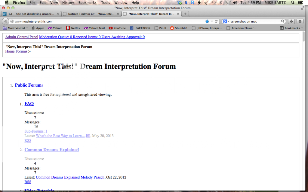

The last 2 days the forum isn't displaying right, the banner and sidebar are underneath the list, if at all, so is the inbox and all the account stuff. I was clicking around and every other time it would be screwed up. Now it's not right at all. Tried clearing cache, switching browsers, a friend verified that it also looked weird to her. I'll add some screen shots...

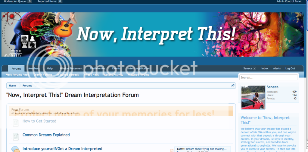

And, what it's supposed to look like.
That is strange. You can go to any link, forum, etc... all looks normal. Nothing changes until you hit the actual refresh button on your browser. Does it both on Chrome and Firefox.

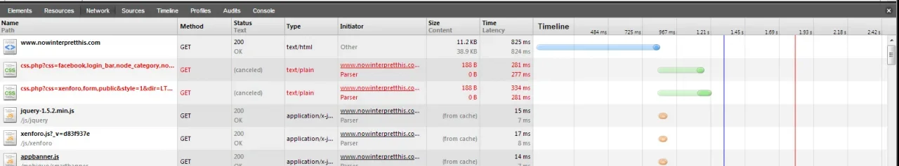

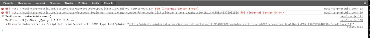

It's hard to tell, as 500 Internal Error is the response code that is coming back on that file
You are also running an old version of PHP, which is End Of Life (http://php.net/eol.php)

You need to check the server error logs to see what is causing that file to error.
Are you running mod_security? I'm wondering if that could be blocking the request on refresh?
