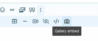

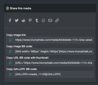

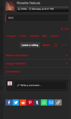

I have noticed that a huge change has taken place in the media gallery and there used to be a load of options on how one could share a photo. Now I see that has all gone and I don't really see how this can be done. I noticed the options on the right bottom that should be sharing options, these ones.
When I use the link option and try and share it I seem to get this
5141940905571615203-jpg.11139
This link that I got from using that option is one of the images I tried to share above and on my site and I just see the 1664040456675.webp
https://www.triumphtalk.com/media/5141940905571615203-jpg.11139/
Seem to work for me.
You try with any other browsers, or disabled any browser add-ons you have enabled?
I have no idea what is causing this but that is a place to start looking I suppose.
Very strange that it worked with you, at least now I have something to work with to try and find out why it is doing this with me. I am using Firefox so I wonder if that could be the issue.
I will try another browser a bit later and see if I can find why this is like this.

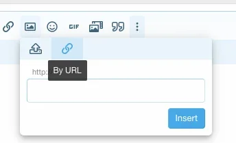

I see no way to post an image using the insert image option so it looks like this.
Is this on your site itself?
But, if using the insert image by URL link I can see where it presents a problem

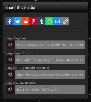

This is where i took the link used.

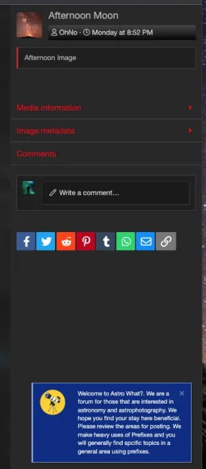

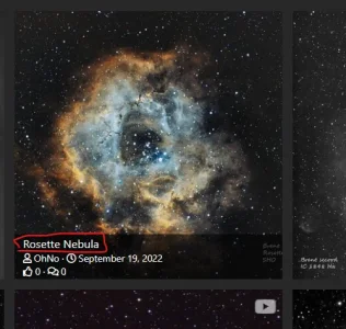

Those don't even show up (the lower portion) on my site for XFMG... this is all I see.
So, apparently there is an option hidden somewhere that you can turn off those links... but I still think that they need an embed button to include in what i show above as if those two options aren't displayed, then one assumes the link button will suffice.
EDIT:
AND the answer is... if you enable Enable media list lightbox navigation in in the XFMG options, that does NOT show up. This is my same site with it disabled.
So... to me, that is a "bug" in the LightBox navigation code... as I said, it SHOULD offer those options as image buttons like it does with the others.
I wouldn't call it a bug. These blocks are accessible even if the lightbox is activated but you have to click on this link rather than the image itself.
On the other hand, it would actually be practical to have this block even in the lightbox navigation. Open a suggestion about it, why not?

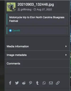

Exactly... and when I visited his site, his are apparently in lightbox mode.. which my site is normally kept in.
Now, when you clicked one one of the images on his landing page in "Random Media" widget, it bypasses the LightBox that is used as shown above and defaults back to the "old" display style. 🤷‍♂️

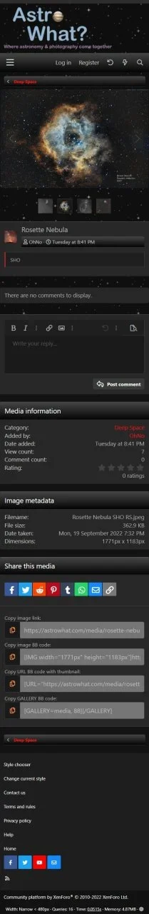

But if you go into the actual Media gallery and click on New Media it displays in lightbox. 👀
Even here, when displayed using the LightBox option in XFGM, those Share Media links to not appear.
The example you showed for my site, you probably caught me as I was playing with the switch config option in ACP... as an incognito browser window for guest shows this for the Gallery entry of an actual image, and visiting on my iPhone shows NO share links at all with the LightBox enabled as either guest or logged in.
