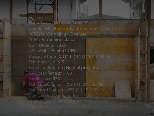

So I wanted to strip exif data (in particular GPS Location data) from all the existing images on the site. There are addons that strip it during uploading of new photos, but not one for removing existing exif.

This strips all exif data, and then replaces the orientation tags. To ensure the photos still display the right way round, as if everything is stripped, apparently that can be an issue. -r might not have been necessary for dropping individual files - I'd used that in an earlier attempt, when running through all the directories in one go (in one folder). But maybe it was still necessary - not sure! It didn't do any harm anyway. -ext data is to tell exiftool to read the .data files in the downloaded directories - because they're not jpegs. overwrite_original is to prevent it making backup/duplicate files (as I understand it). So it keeps the directory folders and file order in tact.
So it just runs (fairly quickly) removes all exif while replacing orientation tags.
Once set up it was quick and easy. So IMO - this is the easy way.
Earlier I had tried to only remove GPS location data with a different command. This threw a few errors and various bits to look at and tidy up afterwards - GPS pointers left behind, uncertain, possibly hidden XMP GPS location etc etc. And the need to run further commands to tidy up. And never quite managing to tidy up all the extra bits. I didn't realise how complex exif is. So in the end I decided it was quicker and easier just to strip all exif data, and completely remove anything GPS related - once I found the helpful command to ensure rotation exif was put back.

After stripping the exif in my 10 directories, I made a copy of each directory folder and renamed it as jpeg, so I could scan through and check all the images looked ok. And also loaded the contents into this browser based exif scanner to check everything was gone (which it was - except orientation tags).
You can run various other commands to check it's worked but I found this a quick, visual way of just checking all was as it should be - my directories contained about 700 files each and I could upload all the files into the scanner very quickly and just run through the results. It's all in-browser apparently, so nothing actually uploaded on the site.
