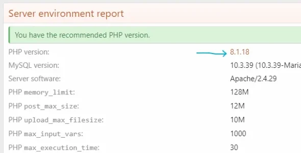

Hint for future use--to see what is available to PHP, open up PHP Info by clicking the PHP version number:
Find the PHP Variables section, and you should see many $_SERVER variables listed. Four of those (on my server) are populated with IP addresses:
$_SERVER['HTTP_X_FORWARDED_FOR']
$_SERVER['HTTP_CF_CONNECTING_IP']
$_SERVER['SERVER_ADDR']
$_SERVER['REMOTE_ADDR']
If you find one of these with the localhost address, you can discover where it is coming from. And among those, you should also be able to find the IP address you are visiting the forum from. $_SERVER['SERVER_ADDR'] shows the private network address at my host, so that is not applicable to the problem here. And $_SERVER['HTTP_CF_CONNECTING_IP'] is Cloudflare specific.
