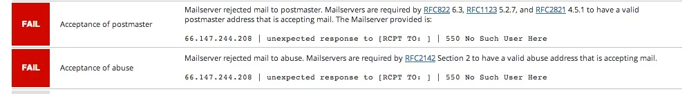

Also, if you do mail on your server (which is responding on port 25) you need to follow the two recommendations (this won't have anything to do with the speed though)

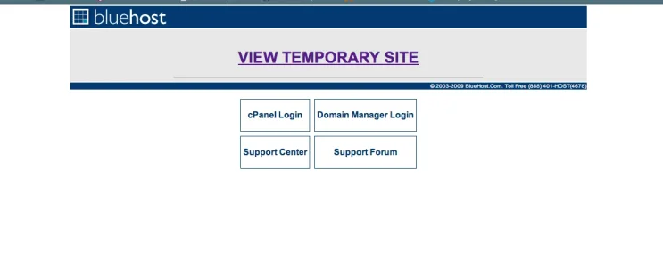

Your server is apparently set up to serve SSL - but no certificate (and it routes to a weird page - probably something to do with BlueHost), but then it redirects to your site with ~khmediaf/ on the end of the domain.
Personally... I'd be running away from them.
