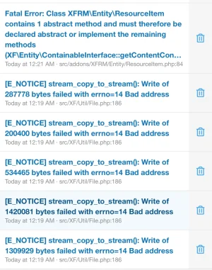

We duplicated our 1M posts forum to test the upgrade first in a test environment, the upgrade was completed smoothly using one click upgrade in admin panel, however, after we entered the admin panel we found the below server errors:
ErrorException: [E_NOTICE] stream_copy_to_stream(): Write of 1309929 bytes failed with errno=14 Bad address src/XF/Util/File.php:186

ErrorException: Fatal Error: Class XFRM\Entity\ResourceItem contains 1 abstract method and must therefore be declared abstract or implement the remaining methods (XF\Entity\ContainableInterface::getContentContainerType) src/addons/XFRM/Entity/ResourceItem.php:84

The XFRM errors will be the result of running XFRM 2.2 on XF 2.3.
The other error is likely to be a server issue. Do you have custom filesystem mounts set up (for S3, etc.)?
