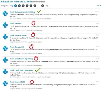

I hereby attached the results when search "Cefuroxime" with check "Search Title only"
Ah I see the problem now.
There appears to be a mistake in your style. Have you edited the search_bar template?
This line is what it should be in the normal default style:
<li><label><input type="checkbox" name="title_only" value="1"
Based on what I can see on your site, this line is actually:
<li><label><input type="checkbox" name="title_only" value="0"
Notice the value of 0 will effectively always mean the value of the checkbox will always be 0 regardless of whether it is checked or unchecked.
