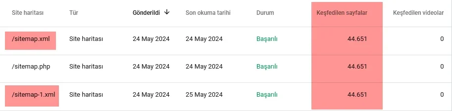

Hello,
As can be seen in the picture below, there are 2 identical sitemaps in the form of sitemap.xml and sitemap-1.xml.
both list the same content.
Isn't there something strange here?

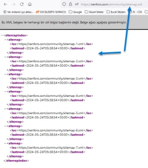

I am also attaching your sitemap.xml image below.
I kindly ask for your help.
Solution
Sitemaps can only contain so many entries before they must be broken up. When this happens, the main sitemap serves as an index of sitemaps. Otherwise, the main sitemap will be identical to sitemap-1.xml. In any case, you only need to add the main sitemap.xml to Search Console. You can remove the others.
