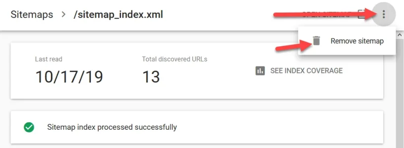

  • go to Google Search Console
  • click on Sitemaps
  • click on sitemap.xml if you see it there
  • on the next page click on the three dots upper right
  • select remove sitemap
The following screenshot is for a non-Xenforo site. The extraneous file for your forum would be title sitemap.xml, probably with an older date for "submitted".
