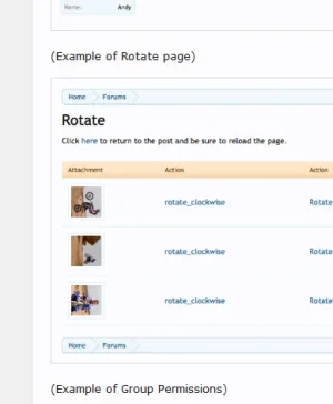

Attached images sometime are uploaded in the incorrect orientation, until now this was difficult to fix. Now you simply click the Rotate link below the post and quickly rotate the attachment to the correct orientation.
(Example of Rotate link)
(Example of Rotate page)

Hello Andy,
Litle style "bug" :
In your template, the phrase must be "rotate_rotate_clockwise" ;)
