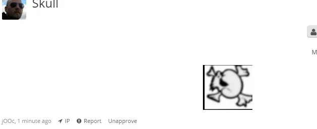

Updated to 1.0.1 and now the rotation works but it still adds a border and blur the image

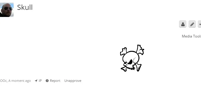

Just added image

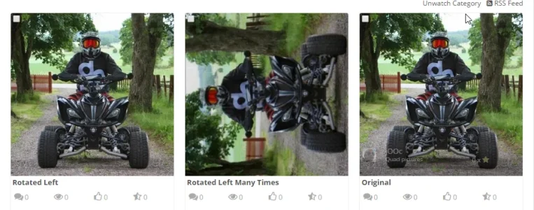

After rotated to the right a couple of times (more blur each time)

There's not a lot we can do about quality issues as a result of manipulating the image. It's probably not the best example. Does it happen with larger images?

Yes it happens on larger images to but only when rotating to the right as I said.
The border is hard to see on this image but its to the right on the middle image
I tested here on your site with the small skull image and it didnt get blured or got a border rotating to the right.

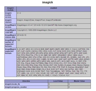

Can it be a imagick issue? What version are you running here?

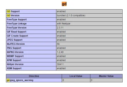

The rotate functions don't actually use ImageMagick. It should be just using PHP's built in GD support.
But, certainly, this is something server related rather than code, unfortunately.
OK, so this is REALLY strange. GD and imagemagick are only reducing the quality of the image when rotating Right. Left doesn't make a difference. As soon as you start rotating right, the quality is reduced each rotation.
