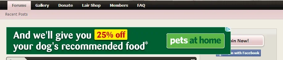

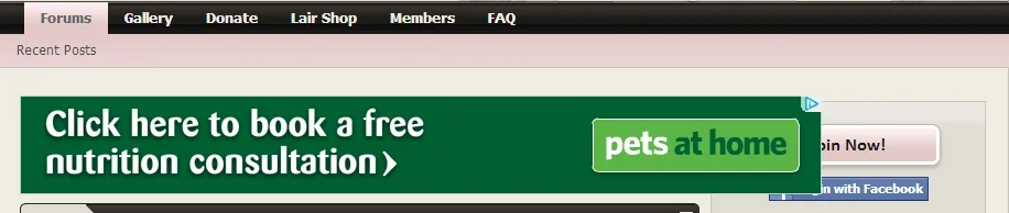

Can you take a screenshot?
Did you reload the page after you re-size the browser width?
i don't think you even need to resize, just drag the window left or right does the same effect, the screenshot would not show anything to compare to as i said you do not have the login area or any element to the right to measure the results properly. yes - i cleared the cache as well.
And does yours as well…

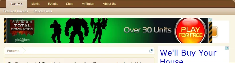

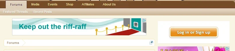

Mine only does that when you resize the browser and don't refresh the screen - that is expected behaviour. Refresh the screen and you'll see that the ad changes to the smaller size. Therefore it doesn't break Google's TOS.
Resize but no refresh:
After refresh:
Your site, on the other hand, doesn't do this between the browser sizes I mentioned previously.
Before refresh:
After refresh:
In my case, I've used responsive adsense and adjusted the settings so that at the width the larger banner would start to obscure the login button, it switches to the smaller banner ad. You need to change the code for your ads so that the smaller banner kicks in sooner, as you are definitely breaking Google's TOS.

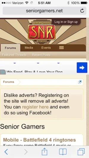

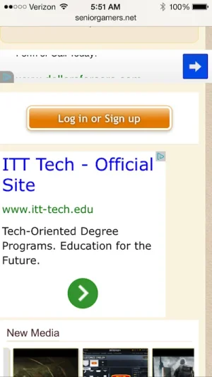

Ok - I think I have it. I had to change @media(min-width: 800px) to @media(min-width: 1025px) what is yours set to @Martok? Also FYI- your ads on iPhone 5 vertical run off to the side and the footer ad needs adjustment - centered, only in vertical position from what I can see.:)
i fixed mine that ran off the side with changing this:
.forum-home-top { width: 320px; height: 50px; to this .forum-home-top { width: 300px; height: 50px;

What screen resolution are you using on your iPhone 5?! It's supposed to be 640 x 1136! Even the basic iPhone has a screen resolution of 320, which should be fine for the smallest ad size.
As I understand it, the iPhone 5 has double the ppi compared to the original iPhone but the retina screen still registers as a 320px viewport.
Blimey! I'd have thought they'd have sorted that and displayed at a higher resolution. Even my old HTC Desire is displaying sites at 480 x 800 resolution.

Either way your ads are offline on the iPhone 4 as well- I have both phones. :D
